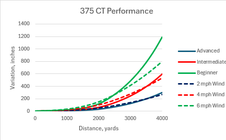

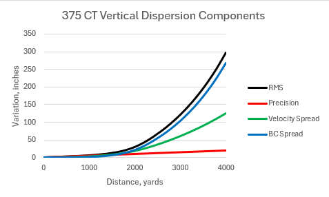

This is the error budget for a well tuned nominal 375CT. 390 ATip, 2950 fps, 0.5 moa 10 shot group, 15 fps velocity ES, 1.5% BC spread.
The 3 components are Velocity spread, BC variation, and precision. They're not simply added together for the worst case, a RMS calc is used for the estimate. Each term is squared, the squares are added together, and then the square root of the sum is the last operation. It's pretty easy to spot check this with a solver. The charts are produced by exporting range cards from AB Analytics and dropping them into Excel.
If you play with that calc a bit, it'll become apparent that even with very low values for velocity and BC spreads, the precision really doesn't matter past a mile. That is, 1/2 moa, 1 moa, even 2 moa won't change much. If we consider that a custom barreled gun shooting premium bullets within 15 fps isn't very likely to put much over 1 moa no matter how long the string is, we might conclude that the precision takes care of itself if the rest of the house is in order.
That's about as good as it gets, 15 fps / 1.5%, let's call that "expert" level. A beginer might start at about 4x those values and we can define intermediate as twice the expert values.
The other popular misconception is it's all about velocity. Velocity moves those curves back and forth on the horizontal axis by about 75 yards per 100 fps. There is far more to be gained by dropping down to the next curve than the next 100 fps. Velocity is good, right up to the point it starts costing velocity or bc spread. In the second half of the barrel's life, it starts contributing to the BC spread and after seeing the effect first hand, you'll be replacing barrels at lower and lower round counts. That next 100 fps costs 1/4 to 1/3 of the current barrel life. If you want max effort "expert" level gun, this is one of the places it comes from. Figure no more than 600 rounds of peak performance for a 375CT that shoots 10-15 shot strings.
I've included a wind level in this one to start reinforcing the idea that range time is much better spent at distance than 100 yards. 2 mph of wind means plus or minus 1 mph. Over the next mile or two. From ground level to max ordinate, say 200'.
