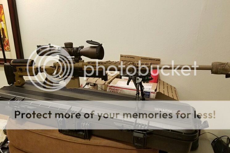

Mausingfield with 6 dasher Prefit

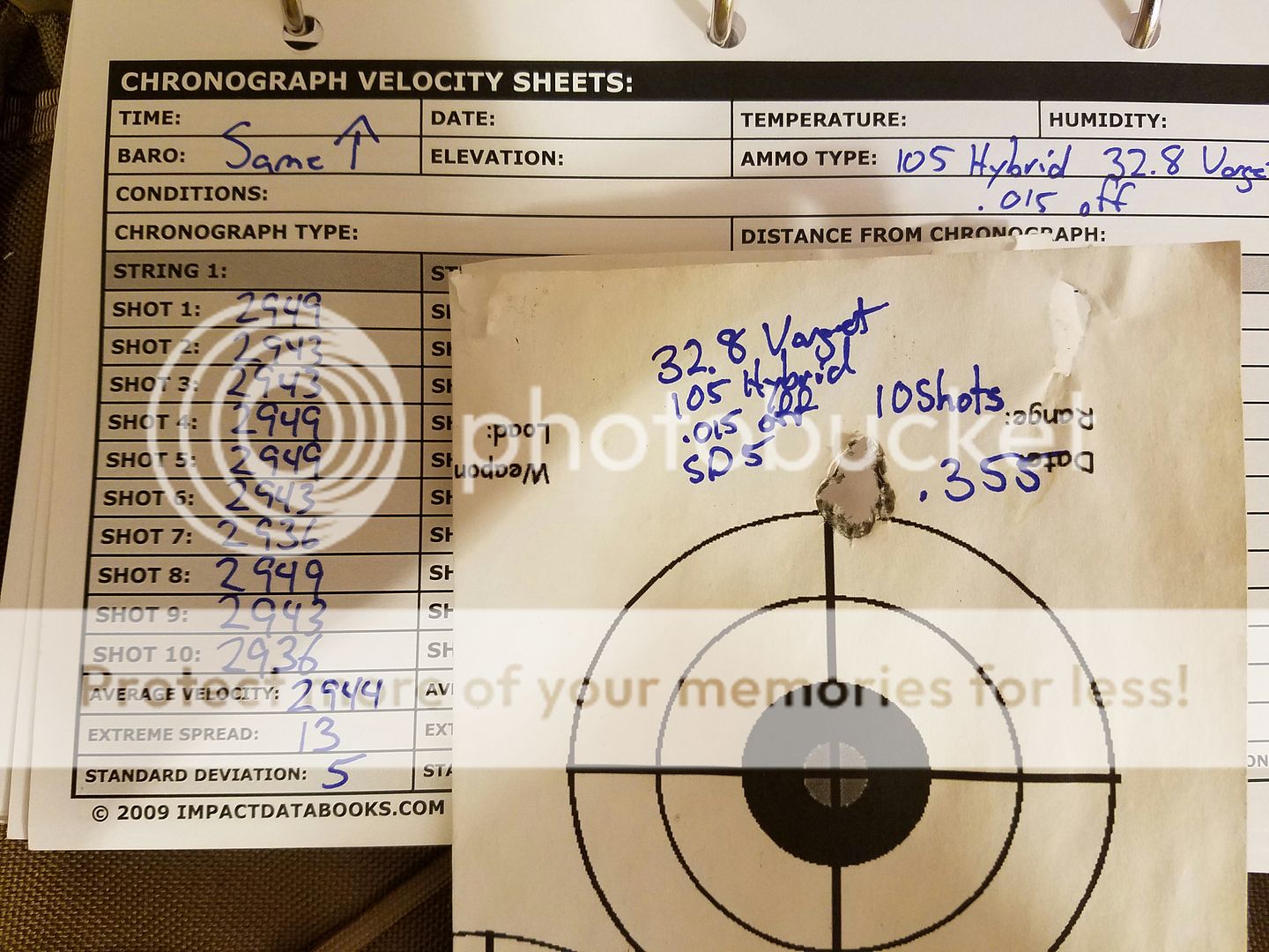

I got my Mausingfield put together this past week and did a little shooting.
Brass is Hydroformed Lapua.
Barrel is a Shilen 26" Rachet 1:8 twist with 2704 neck with 104 freebore.
Berger 105 Hybrid seated .015 off the lands.
32.8gr Varget.
The group pictured is rounds 21-30.
Second best group I've ever shot, I was extremely happy with the numbers.
Awesome. What a great ES also. Assume that is 100 yards. Velocity is right for a 26" bbl.
Accuracy is not right. It's better than that. Hug that rifle.
Nice shooting! Out of a Shilen, no less. Don't let the wife catch you hugging your gun. They get jealous of everything!;););) Hug it anyway.
