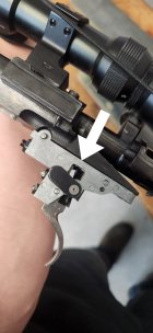

New voere imperial model 2165. Cosmoline or something, really grimey. Wanting to disassemble and clean. It has safety level on right side of trigger assembly. Has a pin with half inch disk holding lever to trigger housing, the ? On opposite side the pivot pin protrudes .there is a small disk, a washer l guess and it appears the end of the pin that goes through the trigger housing is peened like a rivet . Is this correct? The only picture I could find of this particular trigger is on a Santa Barbara mauser. Thank you for any information about this.

Is this the trigger it has? Look at the front bottom of trigger to see if there is a set screw that you can loosen. This trigger looks like it is possibly a Kepplinger single set trigger.
If it is like the other Santa Barbara triggers I've worked on, I have not been able to remove that part of the safety.
It is riveted together.
A bath in an ultrasonic cleaner did a good enough job of cleaning, compressed air finished the job.
Thank you. I wasn't sure what I was looking at. I'm surprised it is riveted on.
