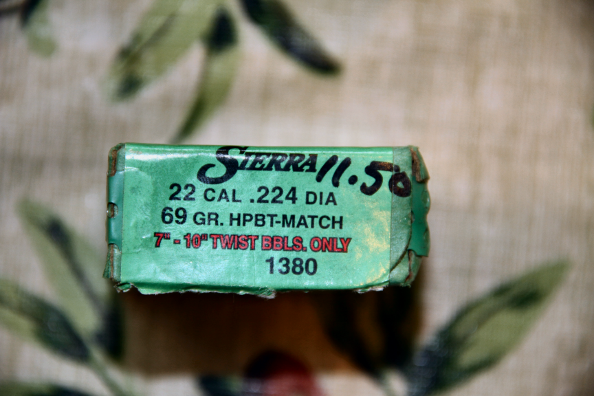

Sierra website indicates that their 69gr Match King Match bullet needs a 10 twist or faster. You may want to check it out.
Good luck with it.
Gerald
https://www.sierrabullets.com/product/22-caliber-69-gr-hpbt-matchking/
I missed that one. I thought all the 69gr and higher bullets recommended 1:9 or faster. Thanks!
