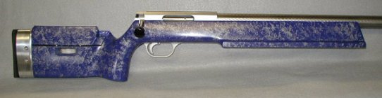

Does anyone own a Master Class Stock? I like the fact that I can have the stock made and fitted by the same people. I have attached the style of stock I was thinking about getting. I welcome all feedback on this project as these are very important decisions I have to make for a $4k toy to play with.

Masterclass fiberglass stocks are made by http://www.robertsoncomposites.com/htmlfiles800/RobertsonComposites800.html
No one does better work than Alex Sitman. And Robertson makes great stocks.
I have both Robertson and Mcmillan and for a prone rifle its Robertson.
Robertson stocks are awesome.
You'll wait a long time on a Masterclass stock. But if you like the laminated look, there are none better.
They will both run you about $800 or so.
You can take a look over on bruno's and see if any of those stocks tickle your fancy.
RHINOUT!
I have several F-Class rifles with Masterclass stocks. I can tell you without hesitation that Alex Sitman,Masterclass) will do an incredible job on your gun. If you want the best, he is it. Contact him, give him a deposit, and get in line as he is a busy guy. His bedding is absolutely perfect and clean. You will not regret it.
Steve and Shirley McGee also make a very nice stock in the pattern you have selected. I have one of their laminated stocks and it is not only good looking, fits well, and was less expensive that Masterclass.
Right now they have quite a waiting list but it was worth the wait.
Bob
Have you checked out Manners Stocks? www.mannersstocks.com Excellent stocks at a good price and not a long wait like Mcmillan or others. Usually about 6-8 weeks.
