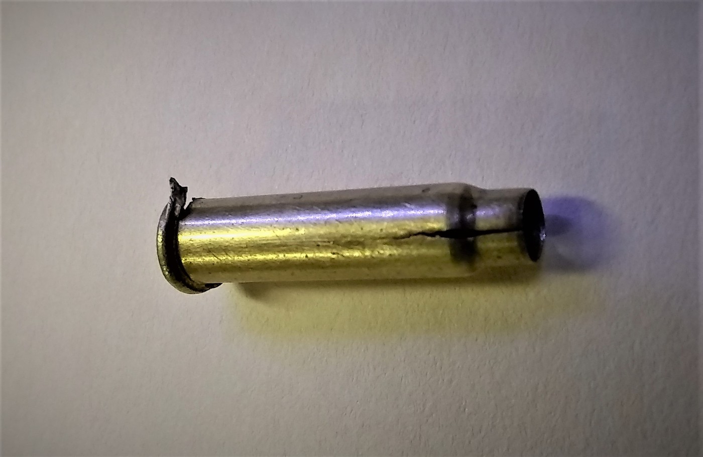

i pull out my old Marlin bolt action yesterday and shot it few times to see where it was hitting at 75 yds. I’ve had the gun since maybe 2000. I bought it for prairie dogs and took it to Montana and quickly learned a 223 at the ranges we had to shoot was better. It only has maybe 100 rounds thru it. The ammo is probably the same age. (20 years +). I noticed the brass had spilt at the shoulder. Should this be a concern? Or just keep shooting? Thanks

I have also had that happen in a bolt action savage and a semi auto volquartsen with hornady, Winchester and cci ammo. I have heard it all when it comes to what causes it. Dirty chamber, bad batch of brass, 17 hmr not designed to shoot in semi auto’s, bad batch of powder, powder measurements to high, dirty bore causing excessive pressures ect. I have called savage, volquartsen, cci hornady and other manufactures and they all have different answers. I had it happen in the past more so and I attribute it to bad brass/powder and or my lack of cleaning between long strings of shoots.
Now I only have it happen once in a while(when I actually look through my spent cases) so I figure not a big deal.
I would guess it’s old ammo and cases are a bit too hard. I’ve seen it happen with numerous brands and in numerous rifles. CCI used to make all 17hmr ammo and private label for everyone, but not sure if that’s still the case or not.
Never had that happen but I’ve read several accounts of brass splitting with old 17 HMR and 17 MK2 ammunition. Another issue reported with old 17 rimfire ammo is loose bullets. Again, never witnessed this either. Supposedly the thin rimfire brass doesn’t like the necking-down process.
FWIW
I've had it happen and what I attribute it to was the 17HMR Hornady I was using was very old. Some of this stuff even split around the middle of the case.
Was kind of scary for sure. Glad I don't have that old stuff any more. I bought some new 17HMR ammo and have not had any problems so far. ;)
I have a Ruger 77/17 and shoot the Hornady ammo. I don’t think I’ve ever seen a case that didn’t split exactly like your pics. I’m a little scared to run a borescope in and see what the chamber looks like but it just keeps on shooting great so I leave well enough alone.
If you're getting split cases on every shot, I would junk it, but if it's just the occasional case splitting, it is probably ok to shoot, but it's your gun.
I've had Winchester 17hmr split at the neck, not the shoulder on numerous cases in my Savage 17hmr bolt rifle. Hornady ammo is the most accurate ammo in this gun. Check RFC for some additional info on the ammo issues.

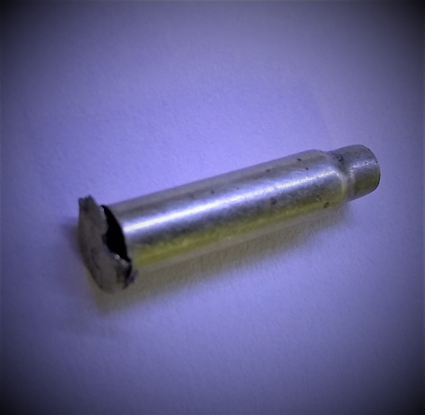

Took my grandson shooting yesterday. CZ-453 / 17HMR Bolt Action
Haven't shot this rifle in close to ten years
Grabbed a few boxes of ammo from my ammo locker and had at it.
Had a Remington cartridge not fire.....perfect rim hit with the firing pin.
Bullet was still in the case upon ejecting. So no bullet lodged in barrel.
Next cartridge blew, sent pressure down the magazine and actually caused the next cartridge in the magazine to exit the case and spill unburnt power in the magazine! Thanksfully it did not ignite.
The pressure expanded the magazine to the point that I had to drive it out from the top. The sides were expanded so I disassembled it and using a small hammer, knocked it back into shape.
This ammo must be 10 years old.
Shot another 50 rounds of same vintage ammo but different manufacture with zero issues.
I did a search to see if there was a recall and all I can find is recalls on the Remington 527 SemiAuto in 17HMR.....and in some cases they are saying to return the ammo too.
Here are a few pictures of the case.
Sent pictures and info to Remington. Have not heard anything in over a week....

I have two .17 HMR's (Savage bolt and a Volquartson semi-auto). I know I have used lots of Winchester and huge amounts of Hornady, along with some Remington, CCI and Federal. No problems except expanded bases using the Hornady lead-free in the Volquartson only. I suspect the lighter bullet allowed the bolt to open just a bit prematurely, so I'd not think ammo was a problem. If I had a case open up like in the preceding photos - I'd scrap the entire lot! I use ammo all the time that is 7 or 8 years old - but was stored in air-tight container with silica pack for moisture. Never a problem.
Check and see if you can find any splits in necks thats still loaded ammo ,Ive found alot of old 17m2 ammo like that:eek:.I was told it had sumin to do with the annealing case forming process when 17hmr and17hm2 started out don't know if they have completely solved the problems are noto_O.This came directly from hornady or cci cant remember which at the moment.I check all of my 17hm2 and 17 hmr ammo for split necks under magnifying desk lamp if its old lot ###'s.I just trash the split necks and try to shoot the old stuff up pretty quickly!Quite a bit of info on the subject over on rimfire centrel at one time.BTW have not found any on the newer ammo lots just the older stuff ,YMMV.
sqrlgtr, Thank you for that information!!! I just looked a few and found one that is split. I opened two boxes and checked some more didn't find any.. I think I'll shoot some more and see what they do. Thanks again!!
