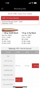

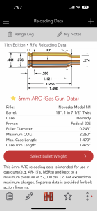

This was the reference I was using
I am getting higher than advertised for 29 grains. I have it written down but it’s around 2615. The last test I did was bothering lever evolution and cfe223.
Yeah, I'd back it down a bit. I don't have a current Hornady manual, but does it state if the test firearm was a gas gun or bolt action?
It’s a gas gun with an 18” barrel. My rifle is a gas gun with a 22” barrel so I figured that it checks out with the extra velocity.
