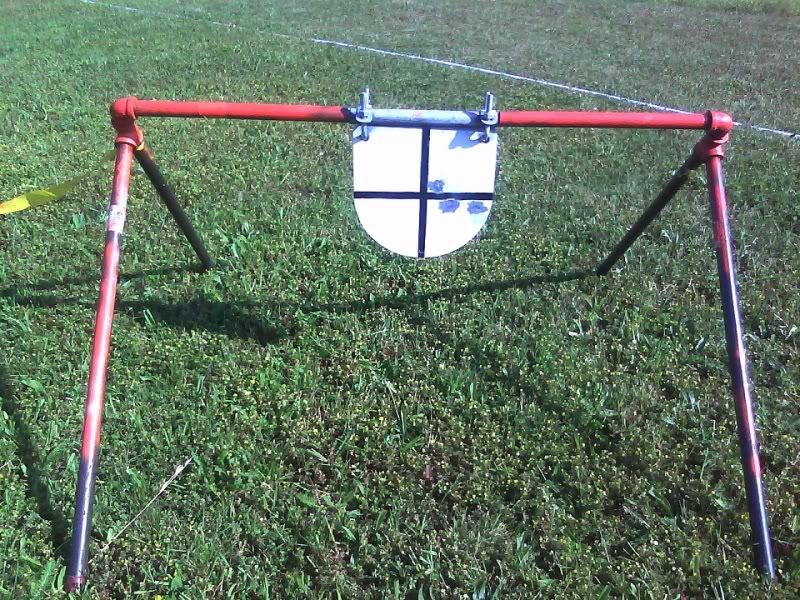

Thanks, Joe. That is an 8" 3/8" thick steel plate that was shot at 700 yards with my 12 BVSS and the 6XC barrel.

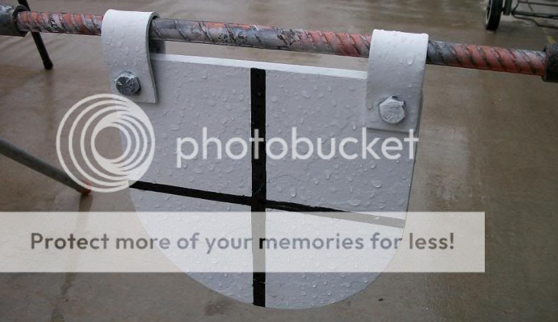

The U-bolts didn't hold up very well, so I went with straps like this.
