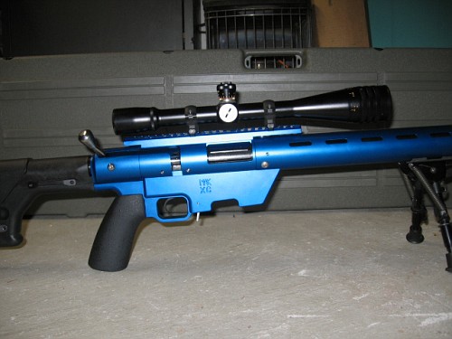

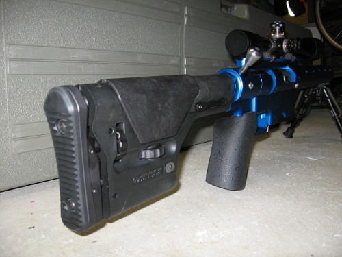

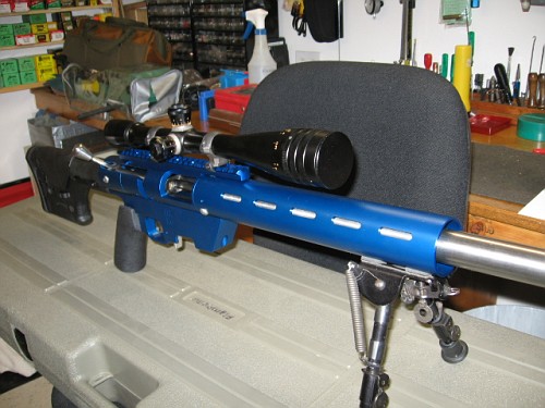

Before:
This picture shows the rifle wearing a 22-250 Ackley barrel before rebarrel to 6BR
After:

That's one great looking setup, Roy!
Looks like the new setup has a different bolt handle. Was that necessary for the conversion?
Tom
As installed in the MAC Kit, is the rifle still chambered in 6BR?
Looks like the MAC can take a magazine. Were you single feeding the rounds?
Nice project... glad to see it shoots so well. You got to love multiple groups under .400. Outstanding!
Yes, currently the rifle is chambered in 6BR with a 1-14 twist barrel. A second barrel is being chambered in 6X47 Lapua with a 1-8 Twist for heavier bullets.
It does use a single stack magazine, but it does not feed 6BR cases well without modification. It feeds the 6X47 Lapua cases perfectly.
For that range session reported, I was single feeding the 6BR cases as the kit comes with a single shot follower that takes the place of the magazine for this purpose.......
