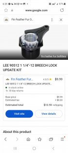

Looks like lee sells that bushing to convert a press over to the breech lock. If you have press that has reducer bushing in top just switch it out. If not bore and thread press for said bushing, not bad at all. Think it is 1 1/4 x 12 thread. Screenshot_20240111_063556_Samsung Internet.jpg
