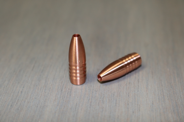

Lightest 270 bullet i know of. Pricey but takes less pressure to move em thru the bore and excellent hunting bullets
