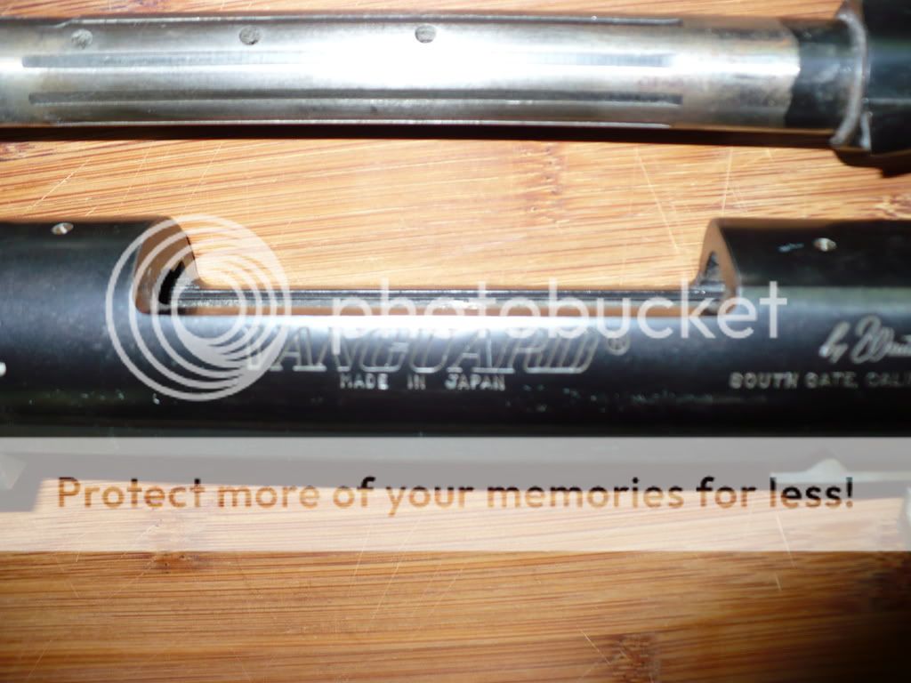

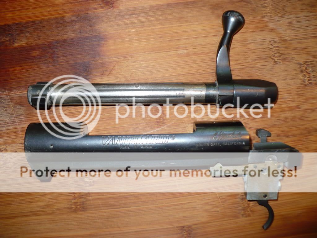

OMG check this out a LA HOWA/VANGUARD action that was chambered in 300 weatherby. What you see is what you get. Not anything special but it has an M16 style extractor,built in recoil lug, one peice bolt and they stiffer than the Rem 700. The best part is its 250.00$ or BO.

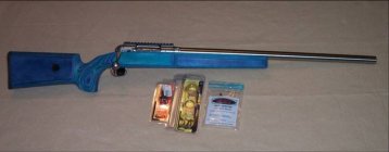

Here is exactly what I have been talking about. It is listed over on LR dot com.
I’ve been acquiring parts to put together an F/TR rifle in .223 Rem for long range shooting. This would make a great varmint rifle also. I don’t have the time to complete the project and would like to sell the package as a whole. The only thing needed to complete the project is finishing the stock, glass bedding the action if desired, and adding a scope and bi-pod. All parts are brand new. They have only been lightly assembled to check fit and for the pics. Here is whats included.
Savage Target Action – This is the 3 screw single shot action with .378 bolt head for .223 caliber. It is in RBRP configuration with the target Accu-Trigger,6oz to 2.5 lbs). Comes with stainless trigger guard, recoil lug and barrel nut.
McGowen Precision Barrel – This is one of McGowen’s Premium Grade SS hand lapped bull barrels in .223. It is a large shank barrel to fit the target action. It is 26” in length and is a 1:8 twist.
The stock is from Sharp Shooter Supply. It is the LVT style laminate stock with the F-Class butt. It has the optional adjustable comb and accessory rail. Color is blue/blue/lt. blue. It comes from SSS fully sanded and ready to finish. Also from SSS are the stainless hex head action screws.
Warne 20 MOA 1-piece steel scope rail Part #M666-20MOA
Bolt Head – Extra .473 Savage bolt head. This is so the action can be used with a .308 etc. barrel if later you decide to change to another caliber.
Burris Signature Zee high scope rings. 1 inch diameter .420 height. Part#420532
Harris Bi-pod adapter to fit the accessory rail. Part #6
I have over $1260 in parts not including shipping. Action from Northland Shooters Supply $430, Stock with options and action screws from SSS $395, Barrel from Northland $270, Bolt Head $20, Warne Scope Mount from Midway $103, Burris rings from Midway $37 and Bi-pod adapter from Midway $9.
I’d like to sell as a package for $1075.00 plus shipping. That’s over $185.00 in savings not to mention the shipping from the various vendors or the 6-8 wk wait for the stock. Shipping will be the actual amount to your zip code. I would estimate shipping to be around $35.00 to $40.00 total. I will ship in 2 packages. One with the stock, barrel and accessories directly to you and the other with the action to your FFL. If your FFL won’t accept a shipment from a individual there will be an additional $20 fee to ship through my 01 FFL. I'm located near Raleigh, NC for anybody interested in doing the sale FTF.
The rifle is listed on several forums. The first “I’ll take it” via email will get it. PM’s or email is fine for questions etc. If you have any questions or need additional pics/info please let me know. mikro1@embarqmail.com If you’d like to talk to me about it, please contact me for my phone number.
Thanks for looking,
Mike
