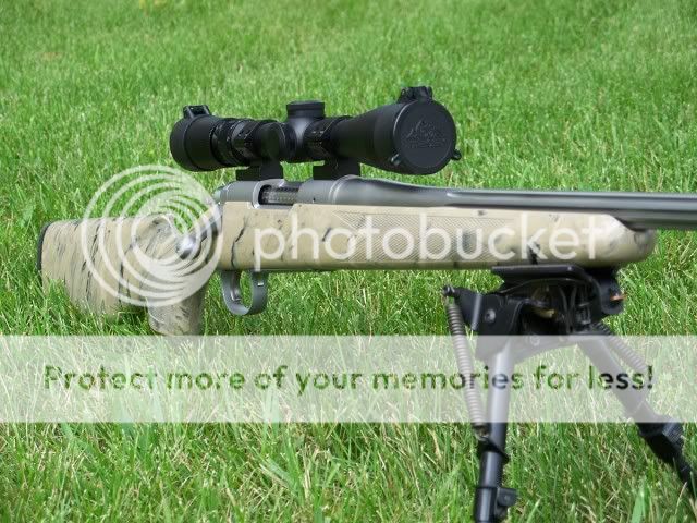

My 7-08.....
Except I had a hard time deciding betwixt the 7-08 or the 260,
so I built one of each. ;D
My 260....
I would really hate to have to pick just one. Like trying to choose your favorite child.
Gearhead, while I have no disrespect for a 243, I prefer either of these two chamberings instead. My 260 spits out 100's at 3375, the 7-08, 120's at 3175 in 22" barrels, which I believe is a step up in performance over a 243.
