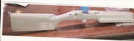

I have attached a pic of a modified Stevens stocked 7 Mystic which I shoot in a local 1000m light rifle class. The stock has wood glued to the sides and plywood across the bottom. That forend is now as rigid as any aftermarket stock. Light too.
If you wanted, you could also modify the rear to ride bags better.
These stocks are readily available on ebay and dirt cheap. Make a great donor for modifying.

Mysticplayer, you and I think along the same lines.:) I didn't want to lay out big bucks for a fancy stock either. I altered my factory Remington 700 stock. It started off as a synthetic / fiberglass varmint stock in black. I did a few alterations. On my band saw I cut away the lower portion of the for end leaving the barrel channel in tact. I cut back to 1/4" of the front guard screw .On the bottom of the for end I epoxied,and fastened with sheet metal screws a section I made from aluminum 2 15/16" wide and 10" long.I drew a center line from the center of the butt to the center of the forearm so I would be sure of good tracking.Between this section and the forearm I placed a section of 3/4" square aluminum frame stock.Now since I was building a heavy gun I filled the frame stock with a mixture of epoxy and #9 bird shot.:idea: The forearm was then shaped filled with fiberglass and a bit more #9 bird shot. As for the butt of the rifle I wanted a target style so I changed that as well. I'll let the photos tell the,as Paul Harvey used to say) rest of the story. My rig weighs in at around 28 lbs according to my bathroom scales. I shoot in the groundhog shoots and their rules state any gun over 15 lbs qualifies for heavy gun or heavy custom. My stock is solid as a rock and tracks very well.

That is a great looking stock. Love the paint job. Very smooth and glossy.
We better not yap too much about these mods or all these cheap stocks are going to dissapear ;)
Awesome.
Jerry
Thank you Jerry, The paint is automobile paint. It's a three step process. When it was finished it actually changed colors from blue to red to purple depending on how the sun hits it. Paint is called mirage.
John
Used a similar paint,prismatic) on my stock. Goes from purple to a reddish copper. Neat stuff. Surprisingly easy to use.
