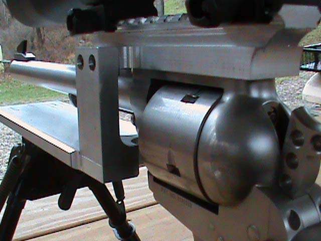

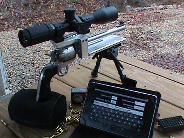

I made a custom aluminum stock for my Anschutz Exemplar 10" bolt action pistol and found it would shoot right with the better rifles but I've always loved revolvers and wanted to build something to shoot long range rimfire with. Rifles are fun but after getting them all set up and running well it gets to be a bit ho-hum. I had a plan in mind that I've been thinking of for awhile.
I finally got the mount finished. No plans, just had an idea what I wanted and a picture in my head. Grabbed some aluminum stock I had lying around and started whittling. Picture Jed Clampett whittling on a stick and you'll be close.
But, as my nickname on here (Topstrap) hints to I do love revolvers, making them shoot way beyond what most think they are capable of to me is really challenging. So I finally snatched up a FA 252 10" Silhouette rimfire revolver. I can't leave well enough alone and wanted to improve on it and have another tool in the arsenal to shoot against the rifle guys with next summer.

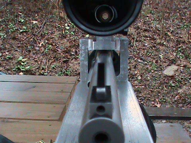

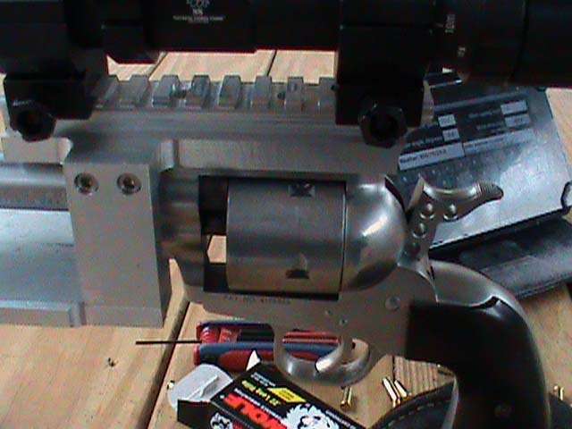

Had to overcome a few obstacles, had to be able to extract the spent casings, had to be able to get to the screw that holds the cylinder in if I ever clean it and didn't want anything hanging off the barrel. I've heard something about harmonics and such if something rubs, touches or hangs off the barrel so I have that covered. Some may say a true accuracy build needs a tuner but this is a revolver so lets be realistic.

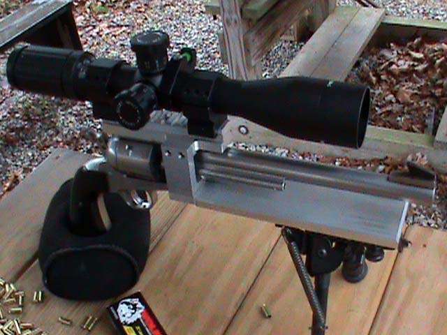

I machined in a 40moa increase on the base so I could dial out to 400 yards just in case..... I put a SWFA 16x Mil-quad fixed power scope on it, they have over 120moa of verticle travel, this is my first try with the mil-quad reticle in one of their fixed power scopes. I have SWFA 5-20 HD scopes on my 1000 yard guns but think the mil-quad reticle on the fixed power is a bit thin. Hope it don't fade out in bright sun, I like the mil-dot versions but dislike the mismatched reticles on them. We'll see how it goes, can always sell it and get the other version.
Tried it out today in the rain, heavy at times and was awfully dark. Took a couple shots to get a 25 yard starting point. Thankfully my calculations and lots of travel in the SWFA scopes it came down to 25 yards with a bit of room to spare at the bottom of the elevation turret.
Used my settings for my Exemplar with WolfMT it ran right out thru the targets out to 197 pretty easily. The little diamonds at 75 yards were a breeze. At 197 with the wind and heavy rain I'd get 3 or 4 hits in a row on the 4" and 3" circles but always have 1 or 2 get blown off. Not sure if it was the weather or just that the gun won't group any better.
I'll do more serious testing on a better day, this was just trying it out and seeing how it liked to be held and making sure everything worked. I have large hands and found the micarta grips are too small to allow my hand to be comfortable with a sandbag under the rear grip. Offhand they may be great but not enough room on a sandbag. I had a spare Pachmayer I just put on which is about a 1/2" longer but haven't tried it yet but it does look like it'll be a big improvement.

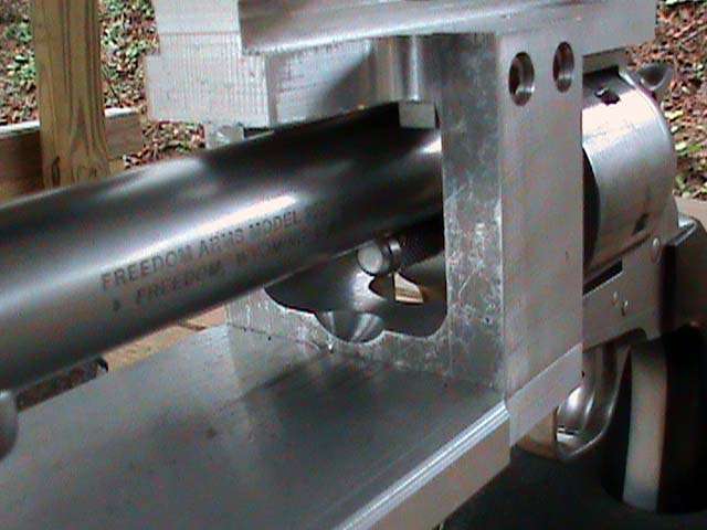

Had to add a slight cutout for finger when pushing extractor rod in.

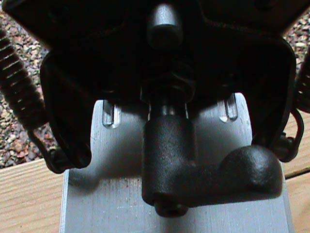

Added grooves for the bi-pod so it wouldn't turn and added some stability.

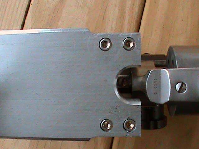

Had to add access to get to the screw holding the cylinder pin in place.

I am impressed. Nice work and looks very functional . Rimfires at distance can be very fun and frustrating
And you say you're NOT a machinist?
You certainly have more effective command of a mill file than I can lay claim to! My metalworking is limited to tin snips & hacksaw mostly, though I do know what 'chalk it up' means when picking up a file....
The man can make about anything he sets his mind to , he may not be able to tell you how he did it but , it always turns out well ! We have been involved in quite a few projects and have a lot of fun doing them ! As Topstrap has stated above , this revolver setup works fantastic , a few of us ,[6 or 7] tried it out yesterday , Jan. 1st at our annual bash and eats at a friends range , at 200,220 and 230 yrds. , it just seemed to easy , we hit steel plates at will , the sizes were 3'',4'' 5'' and other odd shapes and sizes , the one I seemed to fancy was a 1.5'' wide by about 4'' high at 220yds. went 4 out of 5 , the wind didn't help at all , as we were holding , half mill to a full mill , for left to right , gusty at times , 32/35 degrees and so on , tons of fun to say the least , of course we do a lot of this in our neck of the woods , as we have three private ranges close by , that we hold 22RF matches at , one has his 25 to 200 yd course , mine is set up from 35 to 300 yds. and Topstraps is 25 to 200 yds with a fantastic array of steel racks of about anything you can dream up to test your skills or lack of , to shoot at , check out his video's of stuff we do .
I am still surprised by how well it worked. I don't think it made the gun shoot any better but made it easier to take advantage of it's potential. Seeing how well everyone was able to hit those small targets was pretty satisfying.
I think with a bit more range time tweaking and getting more comfortable with the feel I think it'll hang with the rifles. I think it surprised quite a few that got to shoot it. Not uncomfortable at all with having to get up close to see thru the rifle scope.
After you left I took the bipod off and Dennis L from SSK tried it offhand and ran the middle rack at 25 yards of Butches circles, then Chris got the first two and last two on the top row of descending circles barely missing the middle one. I didn't try it offhand yet, didn't want to embarrass myself.
Overall, I like it and can't wait to get back out with it. Now we need to find you one Dale.
