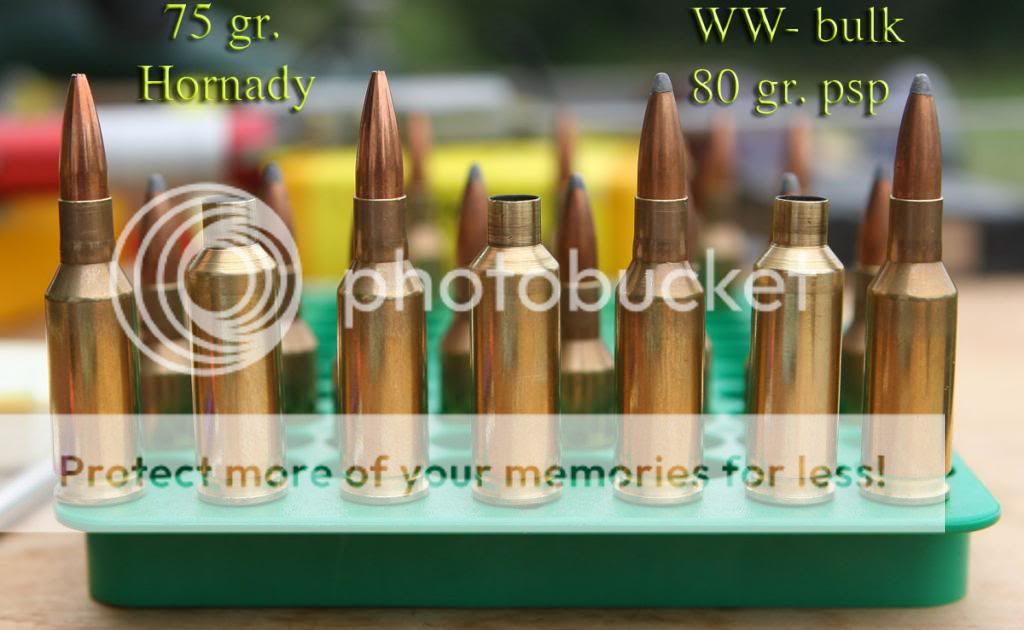

Here is my XP-100 that Jay Cutright chambered for me in 6 Dasher. It has a Shilen barrel with a 1-14" twist and I use it for fire-forming brass for
my competition rifles that he also chambered for me. The pistol shoots 75 gr. Hornady v-max bullets quite well while fire-forming.
Jay used the same reamer on this XP-100 that he used for my first 6 Dasher rifle, back in 2013. As Jay said above, I use the false shoulder method.
I've also used 75 gr. Hornady & even 80 gr. WW-bulk bullets for forming. The 80 gr. flat base WW's are the heaviest bullets that stabilize.
