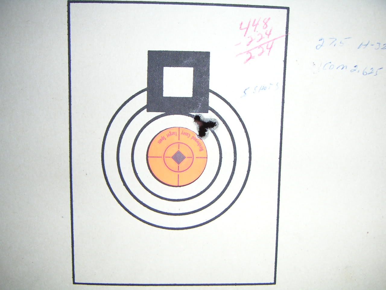

I burn 322 in my 22ppc 27.5 grs but this is a hot load in my gun and should be worked up slowly while checking for high pressure,they will make my bolt sticky on a hot day.
