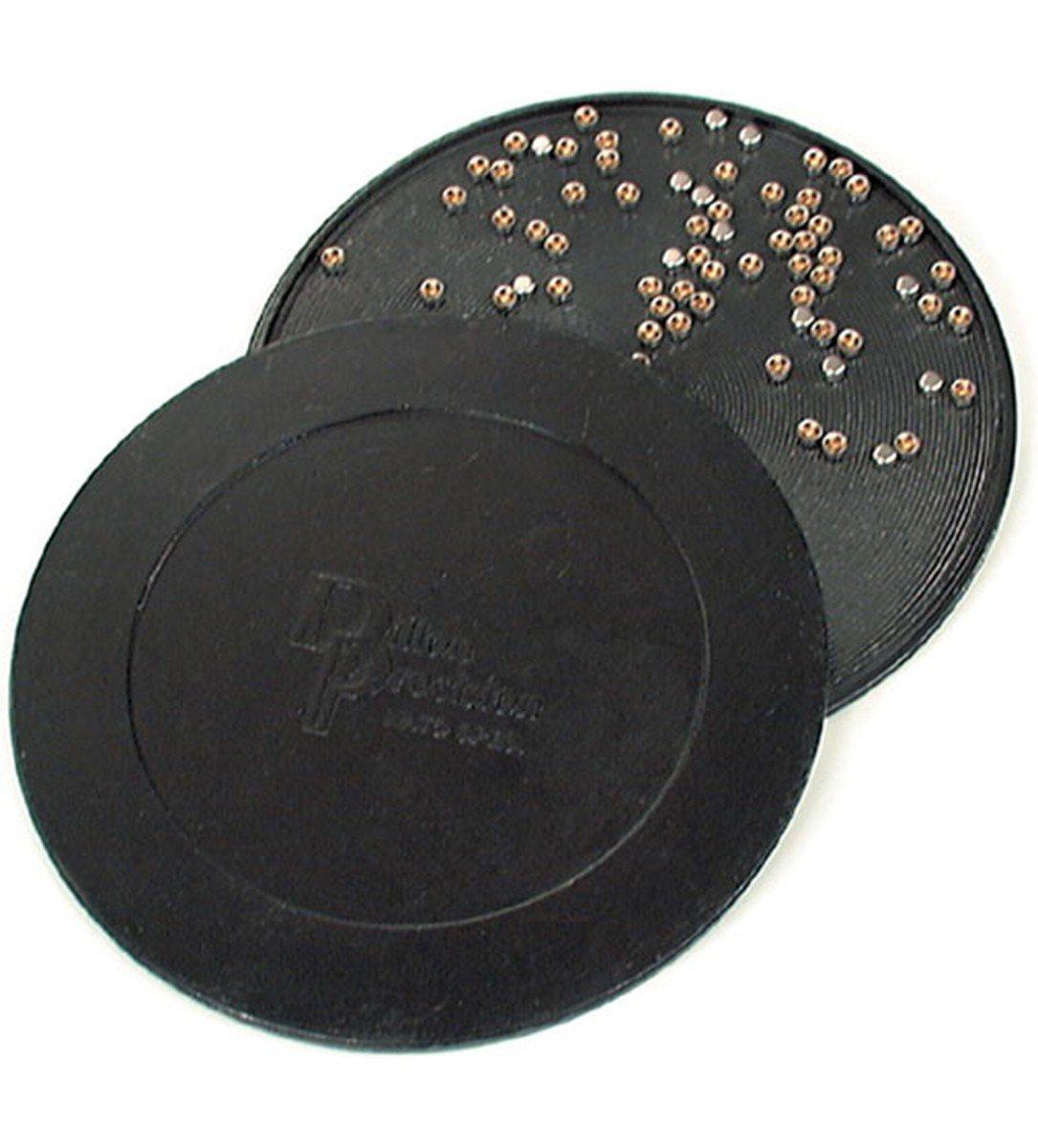

loading primers into primer tube
well first off shake them all so they are all facing up, then put the lid on it and turn it over so the lid is on the table with primers. Now you'll have them all the correct direction for loading into the tube and you can load the tube quickly. Takes um... less than a minute? Not sure how much faster a person needs it to be.
I use a double alpha primafil. Takes 20 seconds to fill a tube w/100 primers.
this
Don't even bother with the shake rattle and roll. I dump them in the tray, pick up the ones that are correct side up, then put the lid on and flip the tray. Resume picking up the rest. Shaking can be a PITA. Just when you try to get the last one turned over, somebody else turns turtle. Maybe I'm just a klutz.
What I do as well! For the last one that sticks in the fingers I use a short piece of bamboo skewer slightly smaller than primer diameter. Don't need a $100 solution to a simple problem.
Is there an easier or quicker way to load primers into a primer tube?View attachment 1755123
