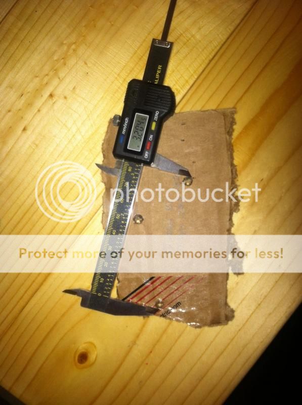

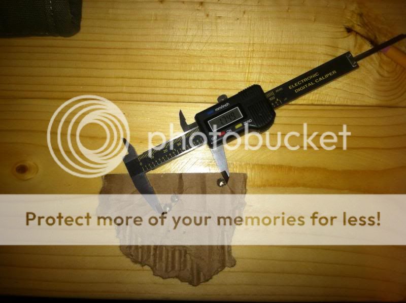

Well, I hit the grind today and kept testing and found my round! So much for selling the No.1 (Thought never crossed my mind). Here were my 3 loads I tested today. Best was the middle with 42gr. IMR4350 and the 90gr. Nosler BT. Definitely sticking with that one.
I was going to ask whether your barrel was an add-on as I thought the 105's to be a bit heavy for what I thought Ruger usually used(?) in .243's, being 1-10" tw.. However, after seeing your sub-half-inch group - it matters not - as that is great for a Ruger #1, custom barrel or not. Good job.
