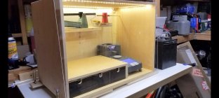

Recently have been struggling to get away from pre-loading and learn to "tune" my loads, adjusting beteen matches by loading at the range. However the increased equipment bulk, set-up and tear-down time, and more time spent loading rather than shooting etc...have me constantly looking for a better way. Here's my current setup, let's see yours. What have you found that increased convenience, saved time, and made your loading at the range more efficient.

To reduce the size of what I have to lug, I combine functions and use a Harrell'c combo press for both sizing and seating, and clamp my measure on a PMA Tool stand that clamps on the table. My entire reloading and range smithing kit fits in one identical to this, now discontinued by Harbor Freight.

I tried reloading at the range several times over the years, made some cases such as those pictured above, tied loading in the back of a SUV etc etc The wind was always able to outsmart anything me. I finally gave up and now just do the seating. Now I just home load three shot load workups looking for velocity flat spots. For the seating tests load 50 rounds at home seated at jam, then tweak the seating depth at the range using a Wilson inline die and a small dead blow plastic mallet
