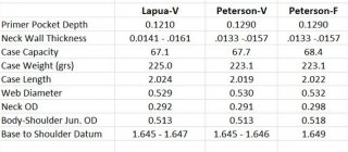

Lapua brass neck thickness isn't always .014", as in one lot of my 6.5 PRC brass it ranged from .0141 to .0161. Because of this, I do turn the necks to .014". :)
Here's some measurements I took when I got some Peterson brass I wanted to compare (interestingly, the neck OD on the virgin brass was pretty consistent):
As you can see, it’s best to get your brass in hand before selecting a Reamer, unless you’re turning.
Even the best is all over the place. I’ve seen Lapua blue box 6BR from .2675 to .272. Think about that for a second.
