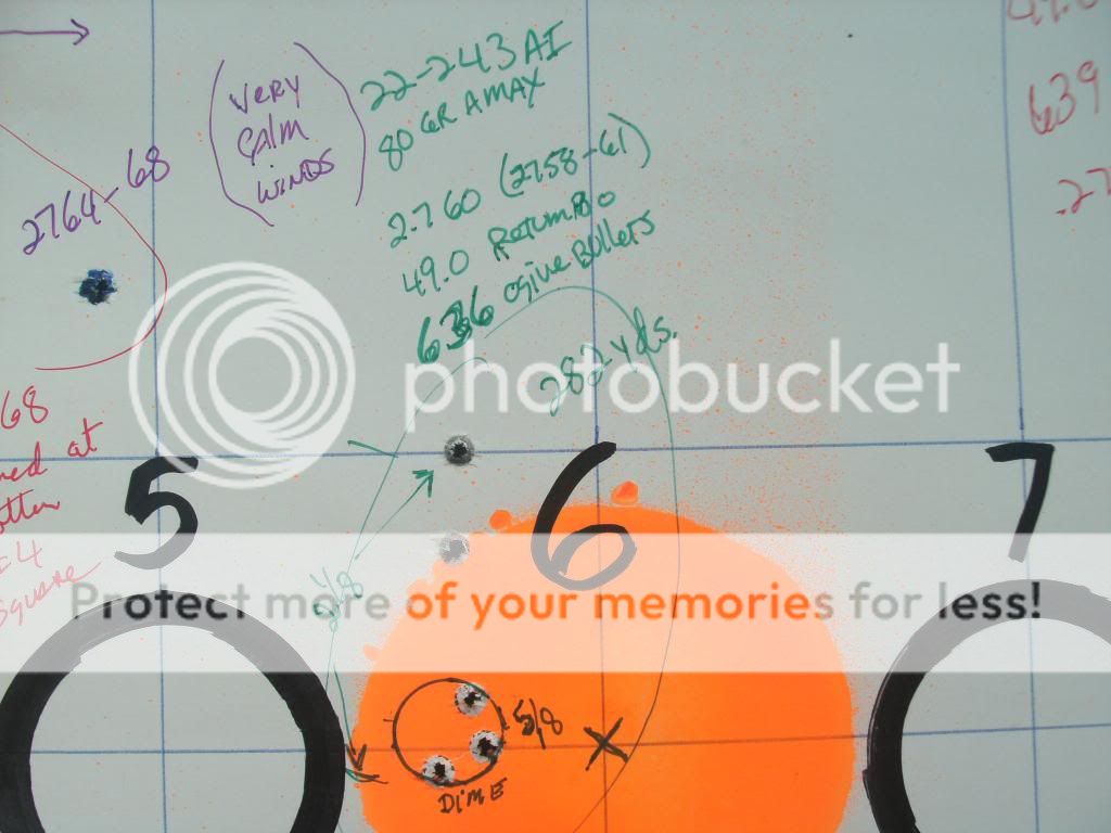

These first two pictures show that the .636 ogive and seating depth is pretty close to being the correct load at 100 yds.

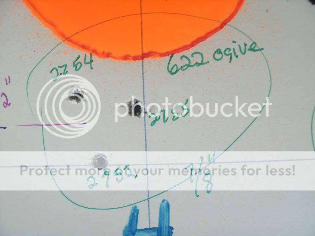

This third pic shows the group getting bigger with a ogive of .622... which is bigger than I'd like.
