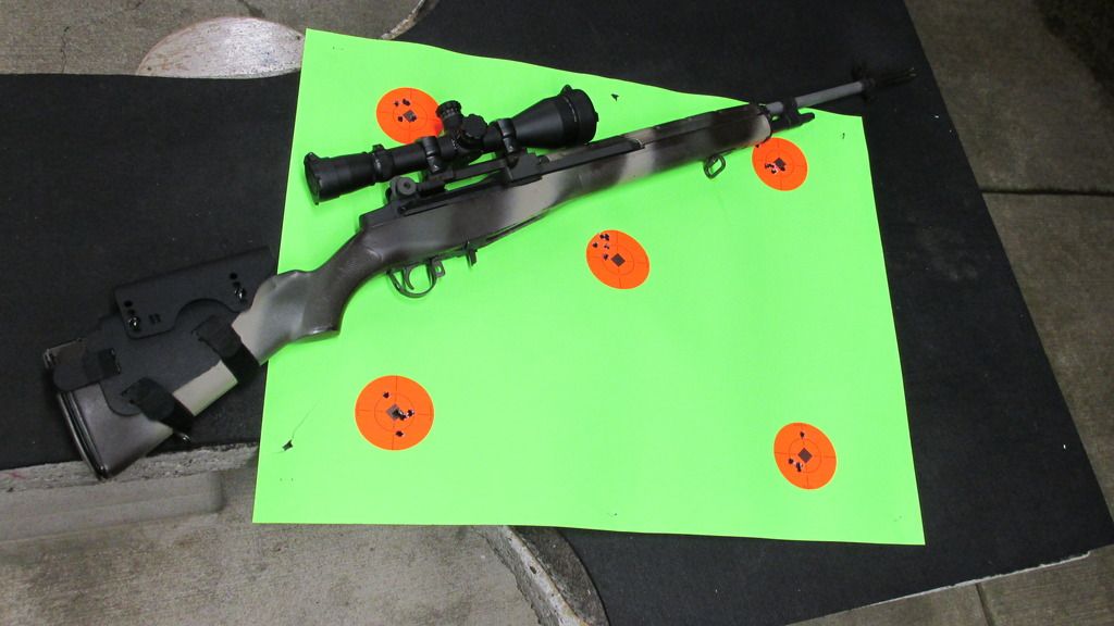

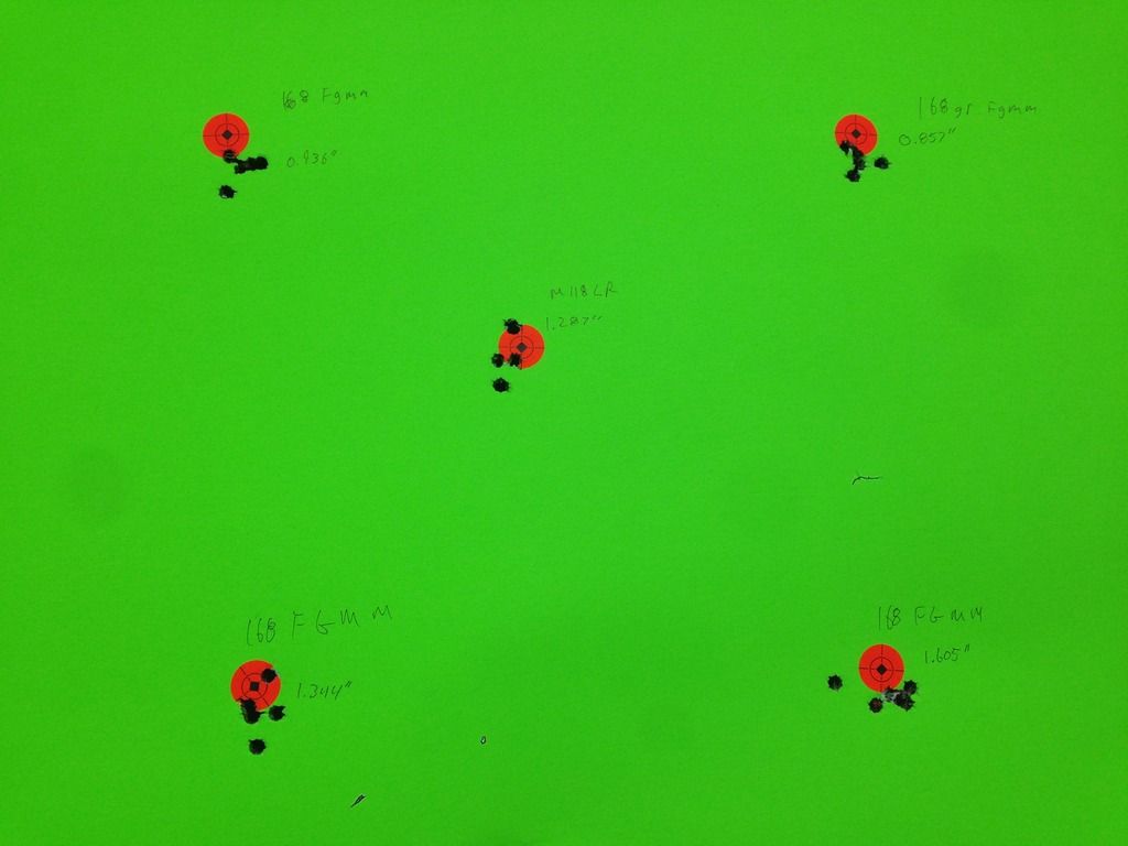

Here are some initial groups at 100yds...
5-shots at 100 yds with M118LR 0.329"
I haven't bedded it yet, nor uinitized the gas cylinder. It's running a Sadlak vented gas piston. Scope used was a Leupold MK4 ER/T 4-14.5x50, FFP, M1 Turrets.
It's in a GI fiberglass stock for now, but it will be bedded into a carbon graphite kevlar match stock in about 2 weeks. Eventually, it will go into a JAE Gen 3 stock.
It has a Jon Wolfe modified medium weight 5R/20 barrel.

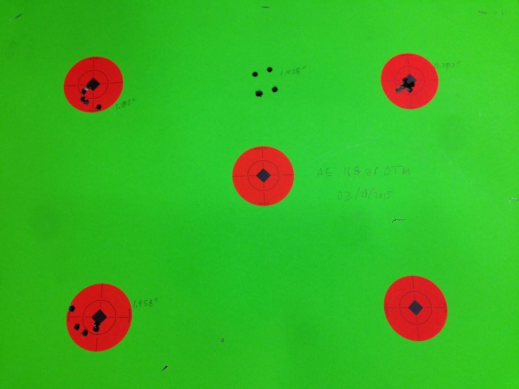

Here's a full update on my 178 grain load development...

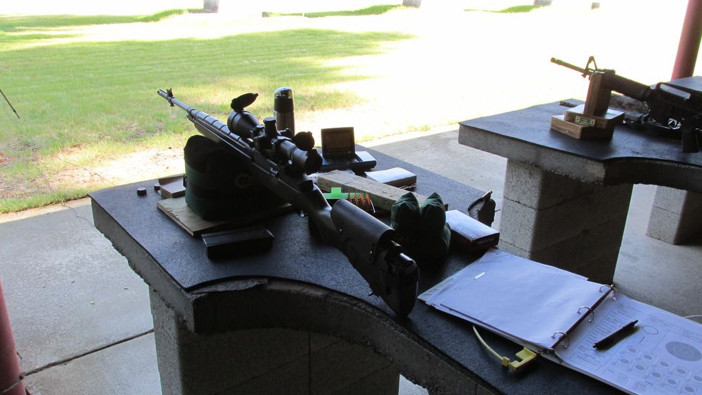

Talk about a great day at the range! I took a couple of friends out to the range yesterday and met M14forum member bfoosh006 at the range for a fun day of shooting and chrono data collection.
My goal was to shoot some M118LR through my new build and to chrono the data so i could build up a load. Things I changed since my last outing was was swapping stocks and fixing a loose operating rod guide. I glued my operating rod guide with red loc-tite and it seems to have held very well. I took my old LRB M14SA out of its carbon graphite kevlar stock and fitted my M25 into it. I got better lockup and draw pressure.
All shots fired semi-auto (gas valve on).
I also mounted my M14SA into a SAGE stock and used the CASM mount to see what kind of results I would get.
(This is one of my guests, not me)

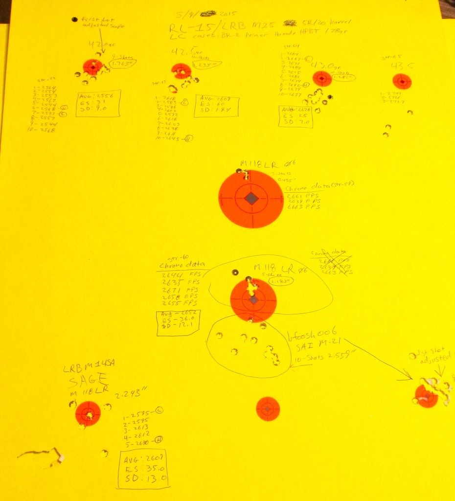

I loaded 5 batches of handloads using RL15, LC brass, 178gr Hornady match loaded to 2.850". Load charges were 10 rounds of 42.0gr, 42.5gr, 43.0gr and 43.5gr. I had a batch of 43.8gr but I didn't have the cojones to try that load after chronographing the previous loads.

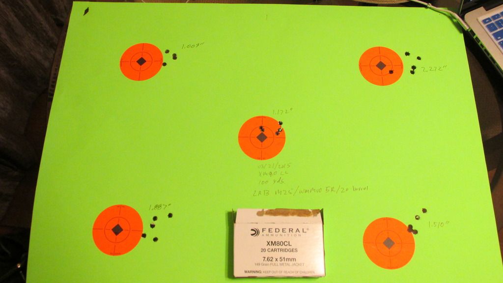

I shot 2 strings of 5 shots each of XM80 ball through the M25/5R rifle.
String 1: ES-11, Average-2879, SD-4.
2882
2884
2883
2877
2873
String 2 (different box of ammo): ES-15, Average-2844, SD-4
2842
2839
2843
2846
2854
I then shot XM80 through my LRB with a 22" 1:12" twist CM barrel in the SAGE stock using ammo from the same box as string number 2 listed above.

I then shot 5 rounds of M118LR through the M14SA. Average velocity was 2609fps, ES-35, SD-13.
2595
2595
2613
2612
2630
I then shot 5 rounds of M118LR through the M25/5R. Average velocity was 2652fps, ES-36, SD-12.1. Group size was 1.183"
2644
2635
2671
2658
2655
The 5R barrel gave me a free velocity gain of 43fps.
I then started chronographing my 178gr hand loads to give me a starting point for my handloads.
42.0 grains gave me a 1.763" group with an average velocity of 2556fps
42.5 grains gave me a 1.235" group with an average velocity of 2609fps
43.0 grains gave me a 1.282" group with an average velocity of 2678fps
43.5 grains gave me 3 shots of 2742, 2726 and 2727. I decided not to tempt fate and stopped there.
I ran some Speer 125gr TNT's through my M25. I loaded 11 rounds and the first round had a different POI than the rest. The next 10 landed in a 0.931" group!
So I adjusted the scope so that POI was the same as POA using a 10-round group which measured 1.204". I don't have a unitized gas cylinder and the stock is not bedded. It was only cleared of enough material around the receiver legs to fully seat the action in the stock. Trigger guard lockup is the tightest I've ever had. I actually had to switch trigger groups from my old LRB to get the action to lock down. My other trigger group wouldn't work.
It all worked out okay because the trigger group that I put on my LRB in the SAGE actually drew down the heel enough so there wasn't a gap. Originally, before the swap, there was a slight heel gap.
Tony.
