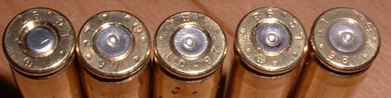

I did a work up in 223 with H335 and 55 gr bullets.
I measured each extractor groove diameter before and after firing.
Vernon Speer wrote in 1956 that he developed loads by working up to brass change, and then backed off 6% powder charge.
