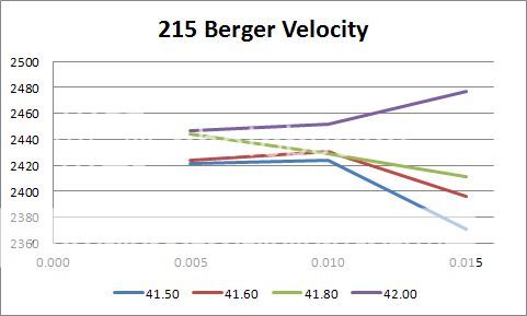

This one tracks velocity by charge weight and seating depth.

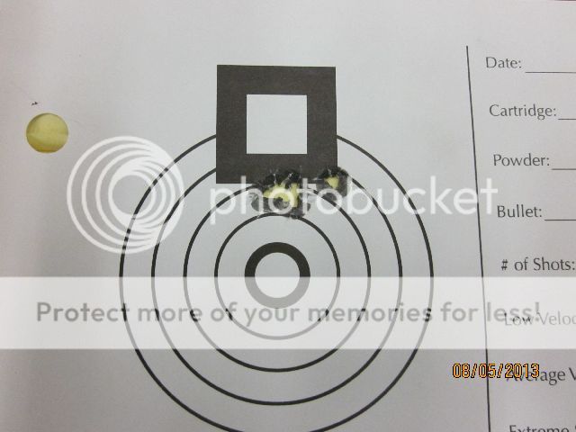

After looking at the charts, you can see the node that seems to revolve around .010 seating depth and 2450 FPS, so I loaded up 5 at 41.8 gr and 42 grains to see if their was a large sweet spot . Here is the 41.8

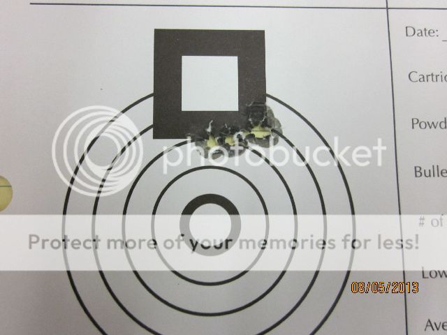

And the 42 gr. Their is some recoil to deal with but these loads look real good.

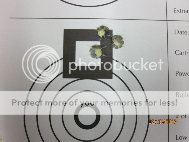

After a pm from a forum member I decided to try 43.2 to get to a higher speed node. The current speed of 2450 gives me little advantage over the juggernauts. I loaded three to check for pressure signs and used once fired, neck sized cases. Very promising. For these 3 loads, es was below 10. Not sure if it will hold that for more shots but looks promising.
