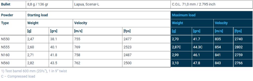

I'm trying to find info for loading up 136 grain Lapua bullets. I having a hard time finding anything that has the loads. Can You guys point me in the right direction? I tried the search and most comes up for 140 grain and the ones I did find were for Vita vuori powders.
Any help is greatly appreciated
Thanks
Mike
This is from the VV data web-site.
