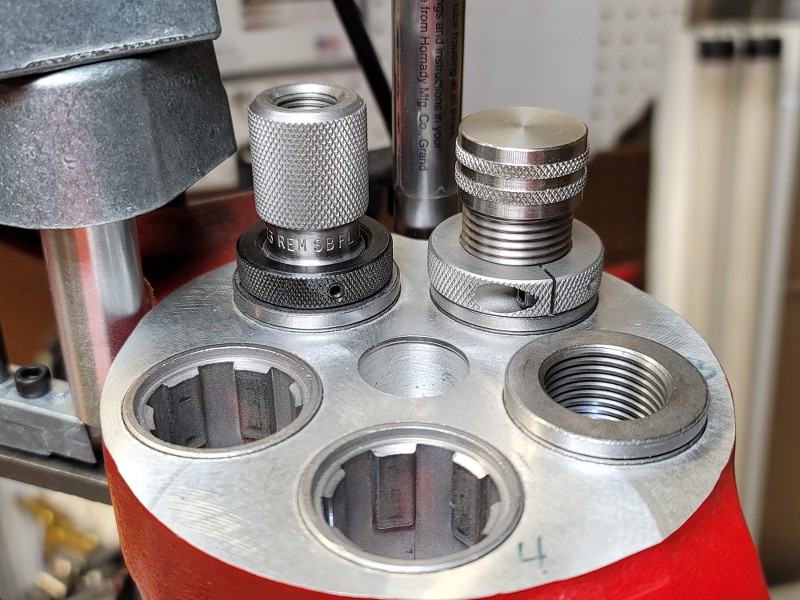

because this is unsorted range brass, I want to use my Reading SB die. I've got it screwed all the way down and it does not seem to be touching the headspace. I've got a Mo's gauge and the cases are all coming out just like they went in. +6, +5, +7...
I'm using One Shot and that seems to work just fine when I screw the die into my Rock Chucker. Cases will come out 0, +1, +2...
Anyone experience anything like this? Seems like the press just does not have enough force to push the case all the way into the die or maybe the shell plate is tipping. I only have two dies in the press. Station one is my Reading SB die and Station two is a Sinclair mandrel. No need to decap since these have had the primers knocked out already.

Gawd I was up so late the other night futzing with this thing! Thanks for all the replies, including forum boss that replied to me in the middle of the night. Utilizing this LNL press for rifle brass has opened a whole set of challenges but the fly in the ointment was not somthing I'd see before.

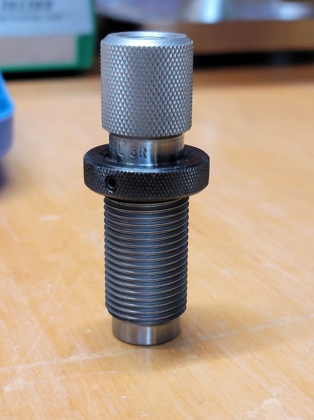

The die wasn't screwed all the way down and it wasn't touching the shell plate. The Reading small base die has an issue with the threads cut on it. I don't think they are full depth threads all the way to the top, probably the last third are wonky. When I was screwing it down to touch the shell plate, it would "bottom out" but in reality is wasn't touching the shellplate, the hard stop was on the threads. I ended up using the die to lap the threads in the LnL bushing to get it to thread all the way down. The coarse grit in a NECO fire lapping kit worked it magic.
It's not that particular LnL bushing either, I checked it on a few that I had lying around and they all had that issue. This is how high the lock ring is when it's properly set. It seats much deeper than on either of my other two single stage presses (Rock Chucker & Classic Cast). The lock ring is just about out of threads when it's properly set.
With regards to my process, I needed to make sure all the range brass was sized enough. Some of this stuff is fine and comes out +4 or +5 on a Mo's gauge but some were really blown out to +20. Brass I use in my Service Rifle comes out +4 or +5. With the small base die properly set, it will bring the cartridge headspace back to about +2 which is right where I want it. There is a very slight cam over.

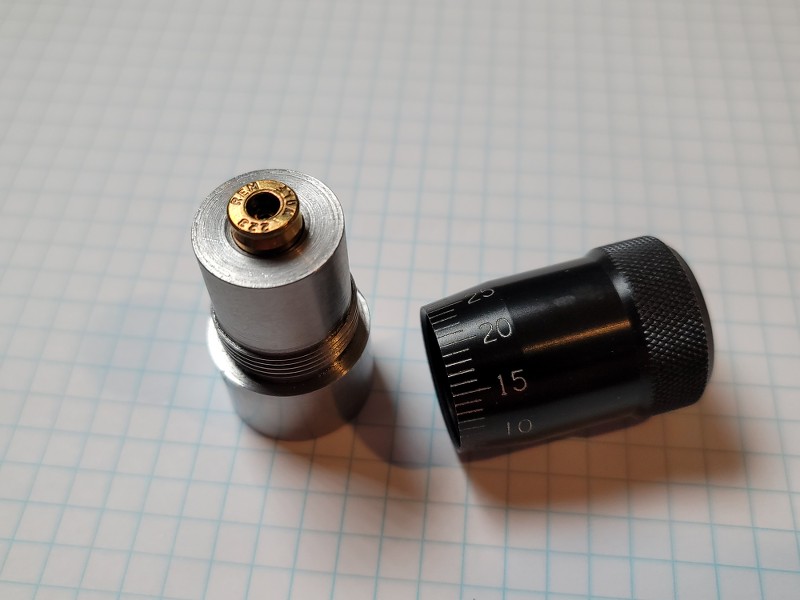

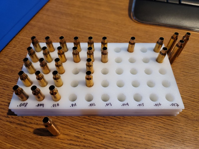

These are some of the unsized cases that were measured with my Mo's gauge.

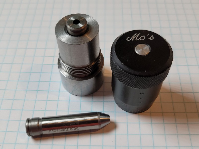

The gauge is basically an RCBS Precision Mic.

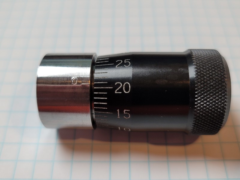

Here is the one that was blown way out to +21.
If you put a headspace GO Gauge in there it will basically come out as 0. Mine is a little wonky and it comes out +2.
