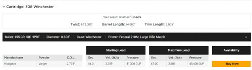

Here is the usual load data off the Hodgdon site for comfort. You should be nowhere near flattened primers based on your charges. If at all possible, track the MV for the next session starting from a squeaky-clean rig and play it safe.
