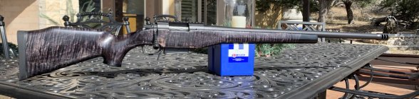

I did this light colored paulownia wood stock a while back. It's root beer candy under auto clear.

After my previous post, I'm not sure why anyone fools with dying wood. i was just tickled with how that root beer stained stock turned out. It was stained and sealed when I got it, but real light and kinda orange. That method turned out nice and was way easier than the previous mentioned ways to get close to walnut or cherry. Anybody with a paint gun can do it, with some patience. By far the easiest way that I've seen yet. The candy acts much more like die than a stain and just highlights the darker ares, but doesn't as drastically change the color. Hard to beat it, really. JMHO.
