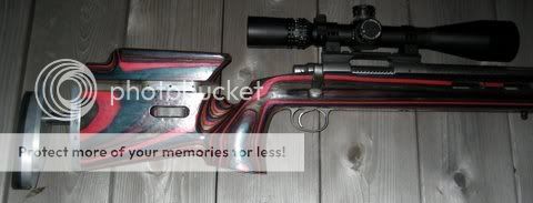

Here's mine, Savage LH SA. Krieger 1-8tw 30" MTU contour, Russo Manners T-2 Stock, Pillar bedded with devcon, single shot follower installed, Rem ADL guard, Leupold VX-3 8.5-25x50. Built by me.
I've shot two F-class matches with it so far. Averaged a 193 at the first match, coming in 2nd, and winning the team match, and the 2nd match i shot with it, I won for the first day, and came in 2nd for the weekend averaging a 195.

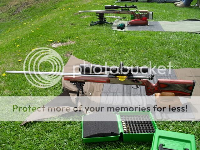

Here are three of mine:
Remington 6mmBR by Speedy Gonzales in McGee stock

Remington 308 by KMW with Badger bottom metal
Same 308 by KMW with US Optics scope
