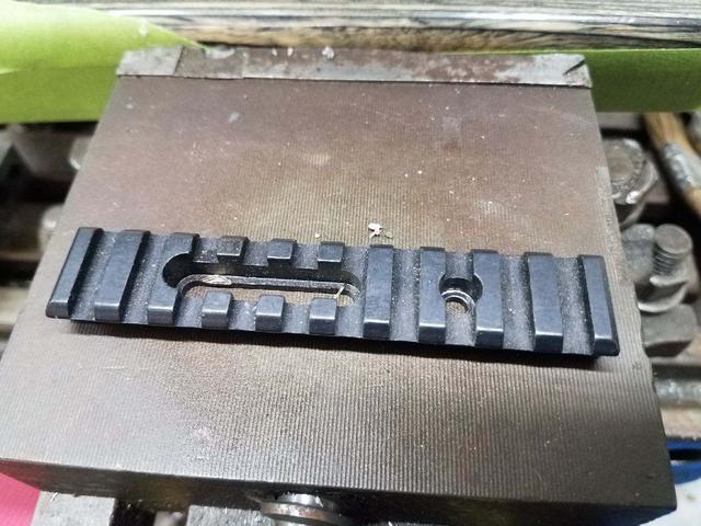

A buddy coughed up the rail.....score!
Then I headed out to the shop and made these inserts on the lathe. Yellow brass, with a 5/16-18 thread (cut undersized so the epoxy had room to lock on to the insert) the boss is 7/16 x .100, tapped 10-32.

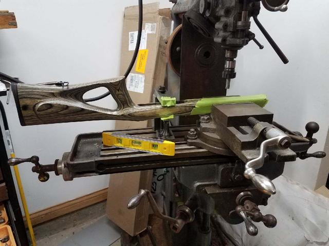

Now we need to drill,tap & c'bore the stock to accept the inserts. This operation was done in the milling machine. The stock was covered in tape to keep from marring up the finish, the forearm end was placed in the vise,a screwjack and clamp were added to the action area.the stock was checked both ways with a level.Time to drill,tap & c'bore.
After "dry fitting " epoxy was mixed up, added to the threads and the inserts installed in the stock. The screw & nut where "locked" on the insert and used as the install tool.
