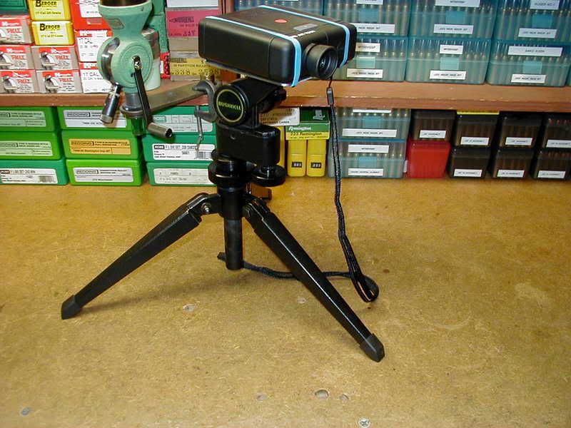

I started out with their LRF 800 when they first came out, upgraded to the LRF 1200 soon thereafter. Also suffered with a Bushnell for a while, and agree that both the optics and overall performance of the Leica are in a different catagory altogether.
One thing to keep in mind, is that they must be held steady for ranging small targets at extended ranges. I whipped up the little device shown to use off the bench for PD's and ground squirrels to give accurate LR readings. Cheap, works excellent.
For the money and from others I've tried, this is the hot ticket.

went from a LRF to a CRF 1200 .. as already said above ... its good but at range on small targets needs a firm support.

The 1200 CRF is just as powerful as anything on the market and it has a good lens. However, It is so small that it is hard to hold steady. When you're trying to range a small object beyond 500 yards, the slightest jiggle in holding will make it almost impossible to range. We got excellent results with the CRF when it was strapped to a tripod mount with bungee cords (there is no tripod socket). Otherwise, it was hard to hold. I recommend the Zeiss Victory. It's bigger, but much easier to hold.
I was told that Leica is supposed to come out with a tripod mount for the CRF. Not sure when, though.

Did a little research. The tripod adapter is out & available. Don't know about stock, however. It lists for $100, the cheapest I've seen so far is $79. Here is one place -
http://www.opticsspot.com/leica-crf-tripodadapter-98750.aspx
