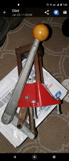

Hey guys.
Going to have to do some work to it but have an old Lee turret press. I want to get replacement turrets so I can set up different loads. I just don't know which turret to order? I think the original was a three hole but there are different ones. Also if they are unercersal can I use a 4 hole instead? Thanks all

Not all of the three hole presses will accept the newer four hole plates. I have one that won't. Not sure how this is determined. Try calling Lee for guidance.
Edit: Just checked Lee's site. Four hole plates will not fit the discontinued three hole presses.
Thx. I looked at replacement three hole. But there are different ones? Mine is pretty old and when I looked for them they had three hole with different numbers. The lee site is down so I can't look it up. Maybe I should just get another press. Was trying to save a buck but the newer kits are tempting, less hassle. IDK
