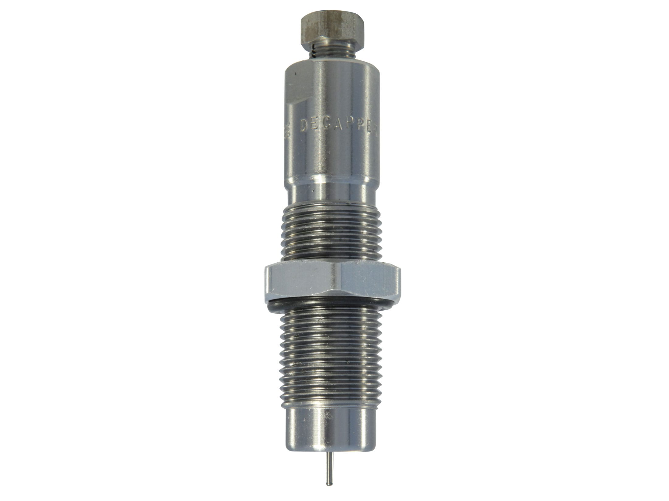

Like has been said use a Lee Universal Decapping Die.
I decap all mine with it except my 6BR. You need the primer out to check how much you are bumping the shoulder.
