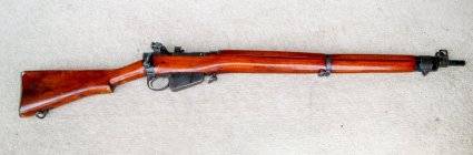

Just for interest - my Fulton's Regulated No4. Built by Fulton's of Bisley in the late 1960's. 1942 Long Branch action. A G Parker 'ball burnished" barrel. Fulton's bolt face. bedded fore end. Parker hale sights. The rifle was purchased by an NZ team member, who had gone to compete at Bisley. He never shot it and sold it to another club member in 1969. He shot it for half a season, before the 308 became the standard for TR. I obtained it a couple of years ago, when he retired from shooting. I'm not planning to shoot it too often, but it does go well ( for a 303, that is).
