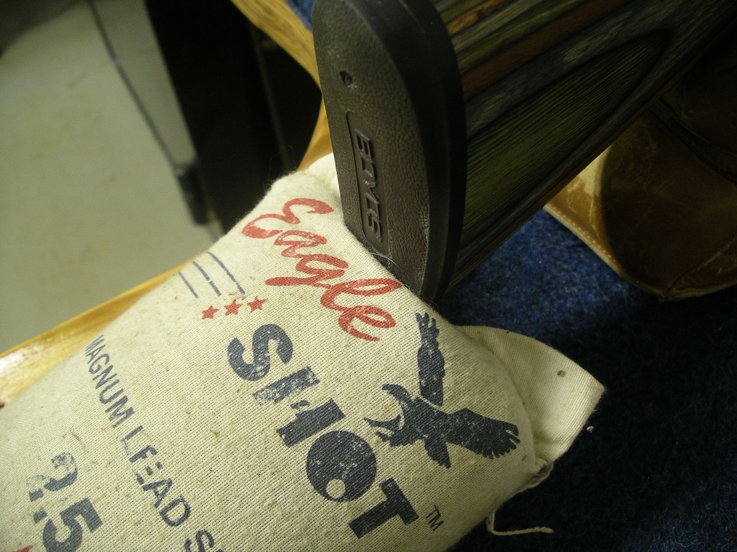

I did tape a foam sanding pad in front of where the butt plate rests so it has a bit of cushion. The block is of fairly stiff foam so I reason it should help keep stocks from splitting etc. without affecting impact.
