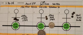

Last trip to the range...
... to verify my load for my Ridgeline 7mm Rem Mag. Can't be more satisfied than I am with the results. Tried 4831sc and N165 but neither gave me the results as that good ol' Re22. spread and deviation not quite what I would like but, I think I will just stick with it.

Those are amazing groups for a magnum cartridge and speaks to your ability to control a caliber with that kind of recoil and muzzle blast.
I could say you are ready load wise for any hunting challenge presented to you. Now it's time to start honing your field shooting skills. ;)
whatever critter that sees the business end of that load isn't going to be around long enough to complain about something better.
