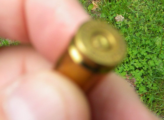

Hi Kevin ,,,did you get my message (been waiting aprox a month now--sent you a message on this board---give me your e-mail and I will send pics ...cant get them posted on here!!)about the 6mm BR brass that I have with primer pockets that are .015-.020" too deep ...I have had frequent miss fires and some that wont fire at all....These folks are talking about a problem that "might" exist....Ihave one that is real....Im shure you are a busy man...let me know what to do...Roger

My apologies but no, I hadn't seen it. You can drop me an email directly at kthomas@nammoinc.com with details, no problem. First question, do you still have any of this brass? Second question, you're aware that both Norma and Lapua primer pockets are just a bit deeper than others? This is why Sinclair and others offer primer pocket uniformers specifically for these two brands; they standard ones generally don't have the depth to make a full cut on either of these two. If yours are .015-.020" deeper, then that's too much. Send a sample and we'll see what's up.

Send it to the same address as the one listed in my previous post to expiper. That's my business email, and I'll be sure to get it there.
Thank YOU Kevin....I sent you the pics of my brass...now that I have your business e-mail it will simplify all corespondance....sorry for using the IM feature here...I realize the importance of communication....I have used Lapua brass since it came into the country in the 80's....222/223/PPC/6mmBR/.243/.308/.30/06/300win.....this is the first that I hav had trubl with .....it is the best out there.....Im shur this was just a production malfunction......the metalurgical quality is beyond all.....Thank YOU for helping me....Roger
