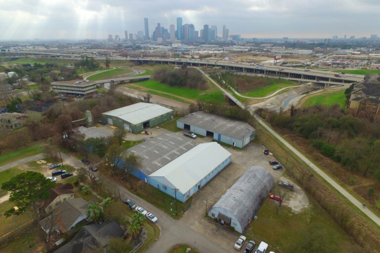

Another place to look local is
It is in the Heights off White Oak st between Heights Blvd and Studewood
