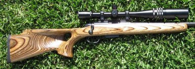

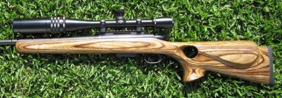

I finished a laminate stock with 3 coats of Danish Oil Natural and 10 coats of Behlens Rock Hard Tabletop Varnish, wet sanding between varnish coats with 600 grit. Final coat was wet sanded 600, 800, 1000 and then rubbed out with Meguiars #3 Machine Glaze. I do not recommend this to anyone. The results were excellent but it took forever and was a big pain. Varnish cures slowly. The attached photos show my old .223 788 in this stock.

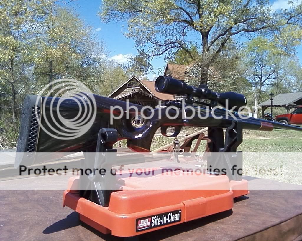

8)I like ur thoughts on how u finish out ur stocks i myself prefer using a linseed oil hot mixed with a selack mixrubbed in to a sheen then cured after that use a hard spar varnish that gives u the depth ur looking for ive done several stocks in the last few months this way and im very pleased with the outcome this is my newist build a 338 win mag on a mark x Mauser action richards microf
it stock
