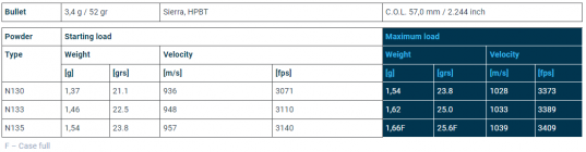

In any case, here is the N133 data from VV's web site showing their recommended start and max charges.
Their data represents a 25" test barrel so adjust expectations for your own barrel length accordingly.
Their spread is from 22.5 to 25.0 grains. N133 is easy to handle with no issues in 223 for your bullet choices. It is in very common use for 223 loads in Europe and very popular here in the BR circles.

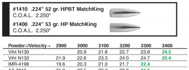

Here is the Sierra data from the main web site. As you can see they are roughly the same from 24" barrel.
