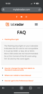

Should be no problem using a card AND external battery. Make sure you have the right kind of card. I thought I remembered a “card” problem. Here’s a screenshot from the FAQ page of their website. I had to have the USB port replaced once as they were known to be fragile. It loosened up enough that shots were disrupting power and restarted the unit every shot. Guys were using magnetic connections to alleviate that situation. Good luck IMG_7232.png
