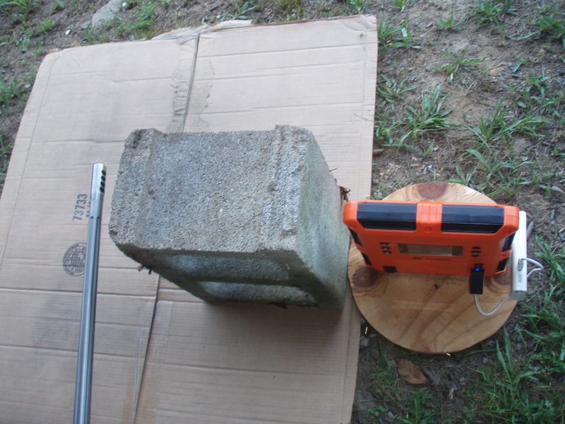

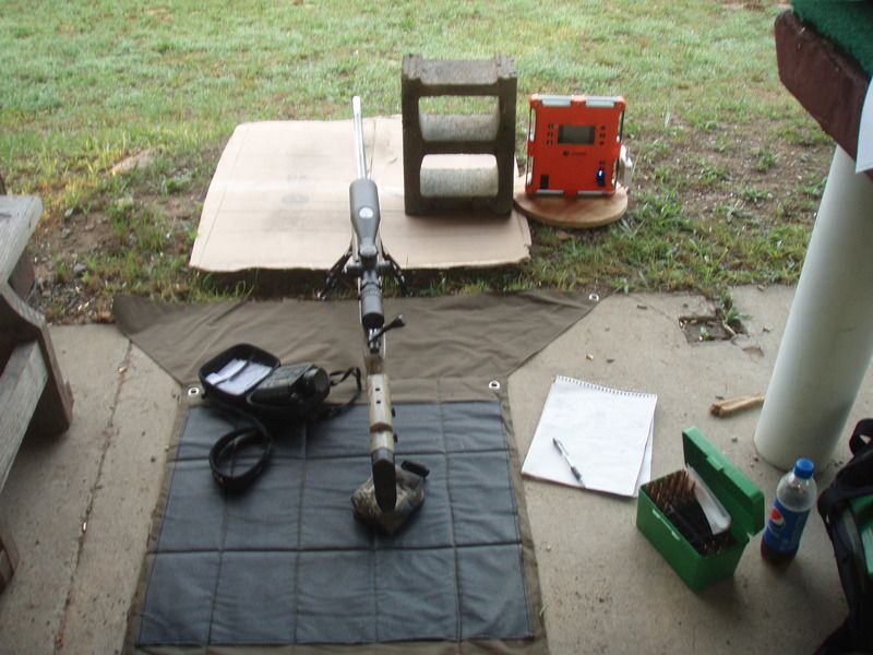

how are you shielding yours from the blast ? I've been using a cement block when I'm shooting a braked rifle . I get the bbl pretty close as in pic two . it's heavy to move around , but it does work . I'm just looking for something easier to carry along to the range . this is my 338LM .
I've had problems with a Little Bastard brake knocking the LabRadar down when I put it 6 inch back and 12 inch to the side. I got it to work by putting the radar something like 18" back and 6" to the side.
thanks I'll give that a try .
It will work because even though the radar is farther away than normal, the louder blast of the brake easily compensates. The only down side is your MV0 will be slightly off by the distance you lied to the radar.
