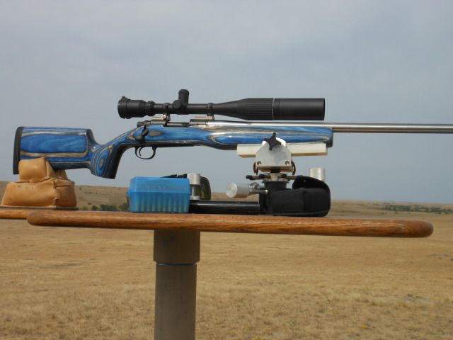

I have a Krieger chambered in 20 Practical , 1-10. It shoots itty bitty groups and cleans up well. I doubt you will be disappointed.
Bowfisher, what are the specs of the rest of that rifle? Very nice. I'm wanting to build something similar in 20 VT.
Otter, I picked this barreled action up unfired from a guy. It was chambered by Eddie Harren, trued Rem 700 action, Shilen 2oz trigger in a Bobby Hart stock.
It's what I call a mid-weight barrel, fluted...I have a Clearidge 6x20 on it. I shoot 39SBK's and H4198 at approx 3800fps.
BTW, viewing through my borescope , this rig has a (from my limited viewing experience) perfect throat , excellent chambering job, IMO. DocEd did a great job on it. Also, it's not picky, it will sling anything from 32's to 40's and stack them all into little piles.
