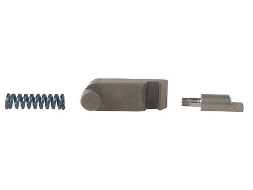

I know this is an old thread, my father-in-law has one of these that's missing the extractor. He asked me if I could make one, is there any chance you've still got the rifle, and if so, would you mind taking a photo of the extractor when removed from the bolt? It would be much appreciated, and would make my task of machining a new extractor much easier.

The extractor is similar to a sako or m16 extractor, also to the extractor on coopers. I'll look at it closer when I get a moment

I'm not expert on extractors but, I think this is sako style. measurements are length .521 width .107. if you google sako extractors, you will see some very similar. here's a couple of links, discontinued but pictures

Thanks, that's a huge help! I should be able to make one pretty easily.
