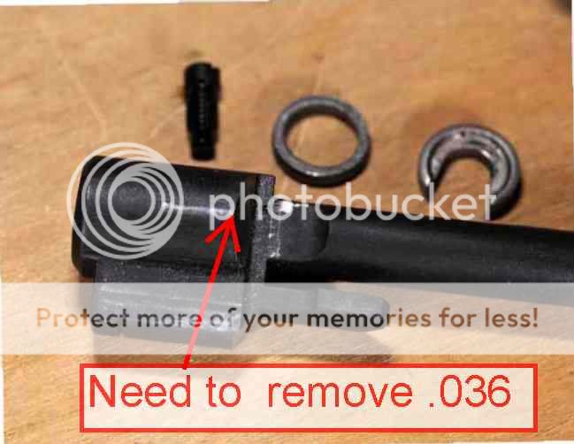

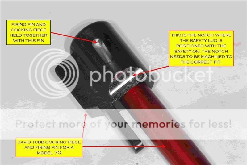

Im not familiar with the Kimber M84 safety, but i have had this problem with Win m70 safeties before. If the safety works like a M70 does then you need to remove & or polish the firing pin in the back notch becuase the safety lever is not camming over in the right spot to engage the firing pin.
You can see where the notch is cut in the firing pin ( big red arrow is pointing to where the problem is) this is where the safety lever cam's over to hold the firing pin back. I used a dremel to remove some material becuase the safety was not lined up with the notch in firing pin. As i siad before i do not know if this is the same on a kimber m84 but thats what i normal do to a 3 position safety on a Win m70. Hope that helps!
