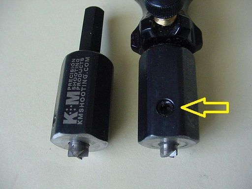

The K&M tools are adjustable (set screw - see image below) and can be adjust to any depth desired.
With that said, they normally come preset to standard (.122").
Donovan
