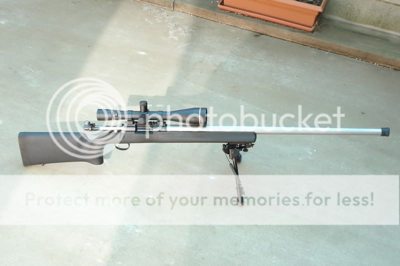

I have just received me custom 6.5x47 lap build on a rem 700
its fully trued squared and blue printed
features a krieger HV barrel, HS precision pst-25 stock, leupold 6.5-20x50 LR scope and jewell match trigger set at about 200gm. so i have fired 35 rounds through it just to run it in using the 120gr nosler b-tip.

I would have uploaded some pics but 151kb max is just silly
the smallest pic i have is 850kb.

but i have uploaded some photos to photo bucket below is the link to get there ... i think.
