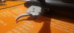

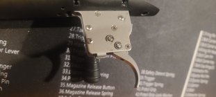

I can't find a picture or a diagram of a Jewell trigger that has this 4th screw adjustment. Is this a Jewell or something else?20250930_184649.jpg

It's a Jewell 2 stage trigger. I don't think they offered or sold them for very long at all. It has a secondary spring behind that setscrew for 2nd stg adjustment and has the extra 6th screw(s) in the sideplate with an extra internal boss for the spring to bear upon.
Adjustment:
  1. Back off 2nd stage screw 3/4 turn (screw #4). Unit is now a single stg unit.
  2. Set 1st stg pull weight (screw #3).
  3. Set over travel (screw #2).
  4. Set 2nd stg weight (screw #4).
  5. Set sear (screw #1).
Screws #1-4 in order from front to back.
Adjustment:
  1. Back off 2nd stage screw (screw #4) 3/4 turn. Unit is now a single stg unit.
Thank you very much for the info. I didn't even know these existed.
Adjustment:
