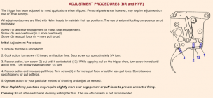

I believe this is a hvr trigger. It came with 3 springs. A is supposed to be installed. I don’t even know where it’s located on the trigger
If 2 rounds means 2 full rotations that’s too much for any of the screws. Those adjustments are 1/4 turn type of movement. I suggest reading the instructions. Safe shooting, cheers.
The trigger spring is under the trigger pull weight adjustment screw. You pull out the adjustment screw and the spring comes out. You can then substitute one of the other springs and replace the adjustment screw, and make your adjustment.
There is a technical manual in Accurate shooter on how to make the adjustments.

From the Manual
Spring force ranges,(typical):
Spring A: 8.0 to 56.0 oz.
Spring B: 2.0 oz. to 16.0 oz.
Spring C: 1.5 oz. to 3.0 oz.
